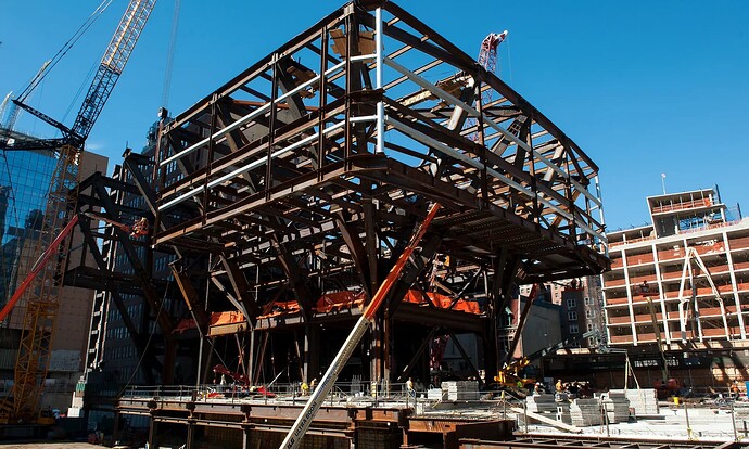

What I think is particularly hilarious is that 1 and 2 Manhattan West may appear similar, but they were constructed so differently that the likeness is entirely superficial.
They’re more like the ‘west-midtown step-sisters who dress alike.’
Wdym constructed differently?
They were built over tracks. 1 is supported by the core with no perimeter columns to the ground. 2 is a more traditional structure with load bearing core and perimeter columns.
Yep barnhillj remembers.
1 Manhattan West has a conventional concrete core and steel exoskeleton above the base.
At the base there are no exterior columns, making the lobby completely unique in the city. (The only building comparable at the base is Citicorp and maybe IBM on 57th).
I believe 2 MW has a braced steel core, not one of reinforced concrete (so more like 30 Hudson Yard and 270 Park).
A good way to visualize this is the end product. Look at the difference in the lobbies of both buildings. 1MW has no perimeter columns while 2MW has them. Different approaches for different ground conditions. It doesn’t show all the differences but its one example.
Very interesting. Now I see what they meant by comparing it to Citigroup.

1 Manhattan West’s lower structure has a lot of similarities to 270 Park, but 270 Park doesn’t have a concrete core which is more impressive.
I personally find the column loads/fan columns and tabletop girder of 270 Park Ave to be it’s unique factor(s), as buildings don’t necessarily need concrete cores to be stable. The reason I find 1 Manhattan to be the more impressive of the 2 is because all loads of the building are being redirected and supported by the core itself, while 270’s loads are fairly evenly distributed in all the ground floor columns that it does have, which makes it somewhat more similar to 2MW in that manner. If 270 “had” been designed to have been similar to the case at 1 MW, then it would’ve been the more impressive building due to it’s size.
I did this for a class assignment in college and it really made me appreciate 1MW more than I already did back then. It’d be interesting if I did another for 270.
