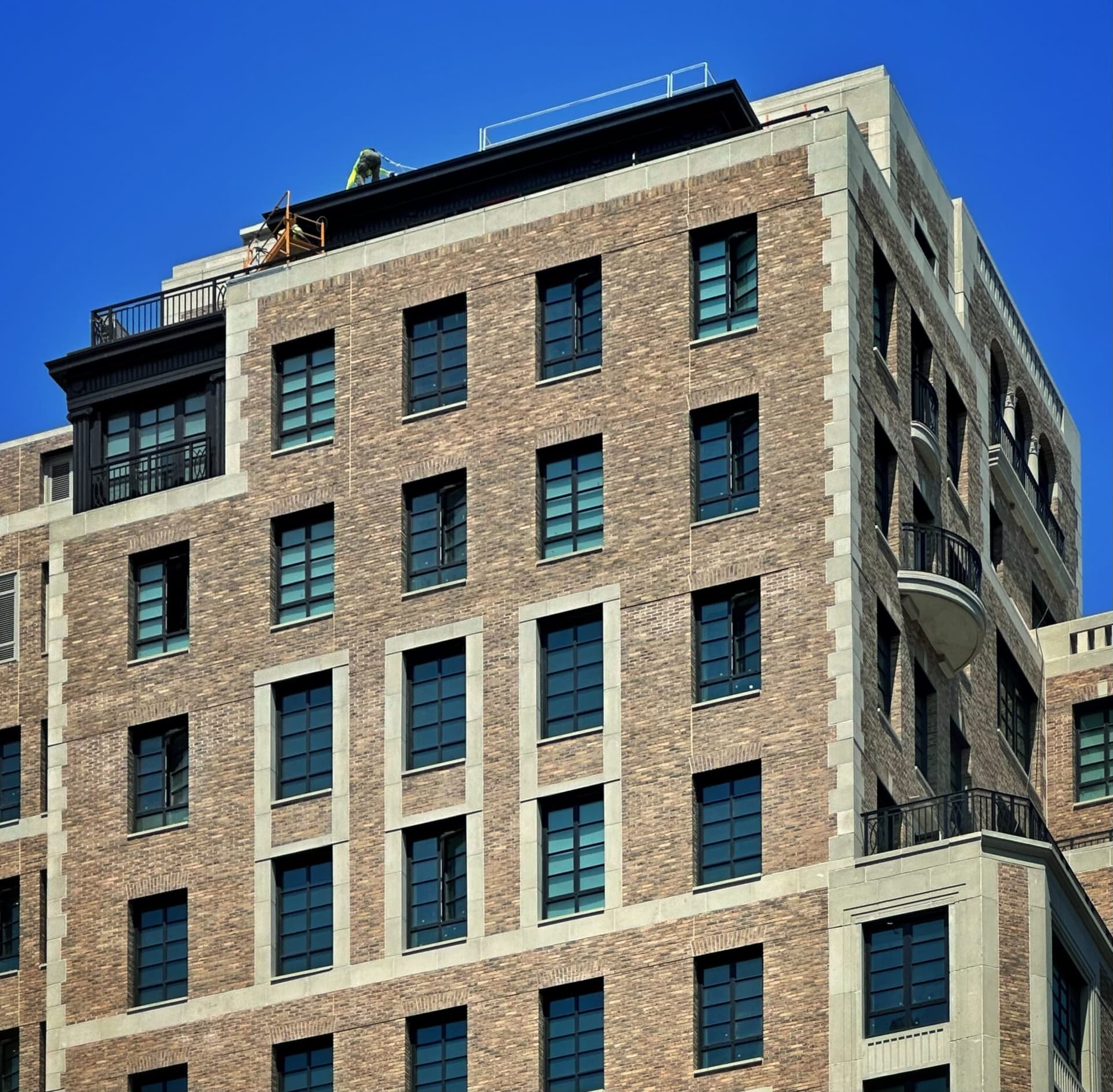

Those in-the-know do know the brick facades are composed of prefabricated brick ‘panel’ sections - which are attached to the facade in a patchwork assembly. I only which they would make the simple added effort to color the panel-joint sections to match the color of the bricks: those light colored joint lines would litterly disappear from sight.
Photo taken from the YIMBY feature article posted above. Photo by Michael Young
Those visible vertical line seams would be an easy fix. :thinking: :wink: :grimacing:

Could be that the seams darken with time.
Yes, that does seem likely. The soot in the air, or simply fading with time - those 'bright" vertical joint lines will fade from site.
It is not IMHO something that should be left to be corrected by the natural elements of time, weather, and atmospheric pollutants. :rofl:
It reeks of shoddy workmanship. The Vitruvian Triad calls for BEAUTY, Solidity and Utility. This one is a BEAUTY: but the Solidity/Construction Quality may be lacking. :thinking:
It could be that they planned the eventual color change so it won’t be too dark in the future.
That much I do agree with; highly likely.
My quibble raises another question when it comes the the Vitruvian feature of FIRMNESS/ SOLIDITY in Architecture. It seems to me (no pun intended) that gap between the brick panels is too big, and perhaps poorly installed; and therefore needed all that mortar to fill the space. It calls into question the “construction quality/solidity/firmness” of the finished product.

They have to plan for heat expansion.
This building is another instance of hand laid bricks (not prefabricated panels) and stone. The lines are expansion joints that are filled with backing and silicone/sealants, not mortar. All brick veneer buildings have expansion joints, you’re supposed to have them. The joints are no bigger in size than the typical mortar joint between the bricks and stones, its just that its a different color that its more noticeable, has nothing to do with the construction quality.
