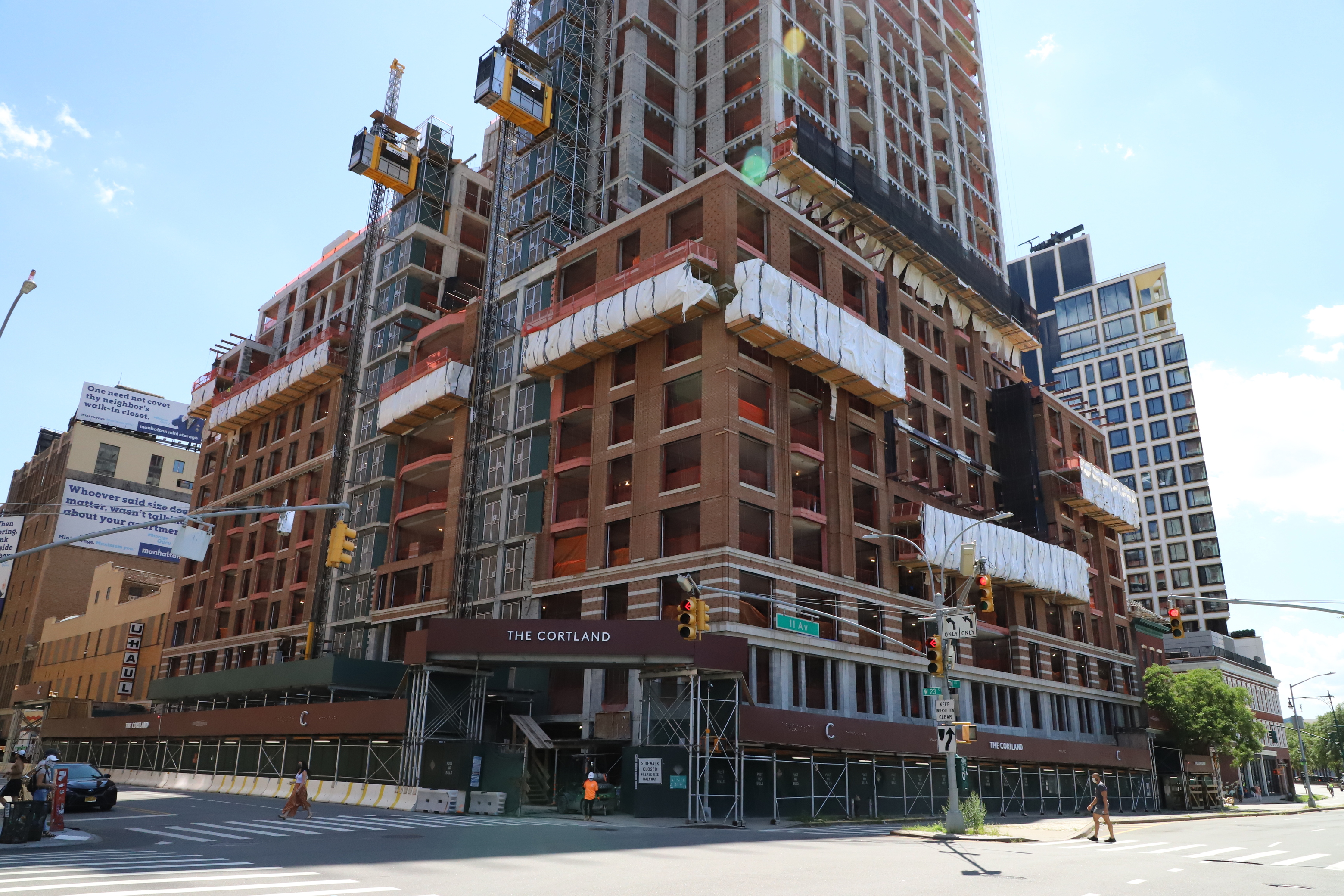

Does anyone know if the brick laying is done by hand or by machine? A lot of interesting patterns going on here.
Stern is extraordinary.
The bricks are hand laid. The scaffolding hanging from rigs on the roof carry the masons and move up and down as needed. It was a frequently used system in DC during the many years I lived there but is seen less often here. Systems like this have been used at many of Stern’s buildings. He likes bricks and the patterns they can create.

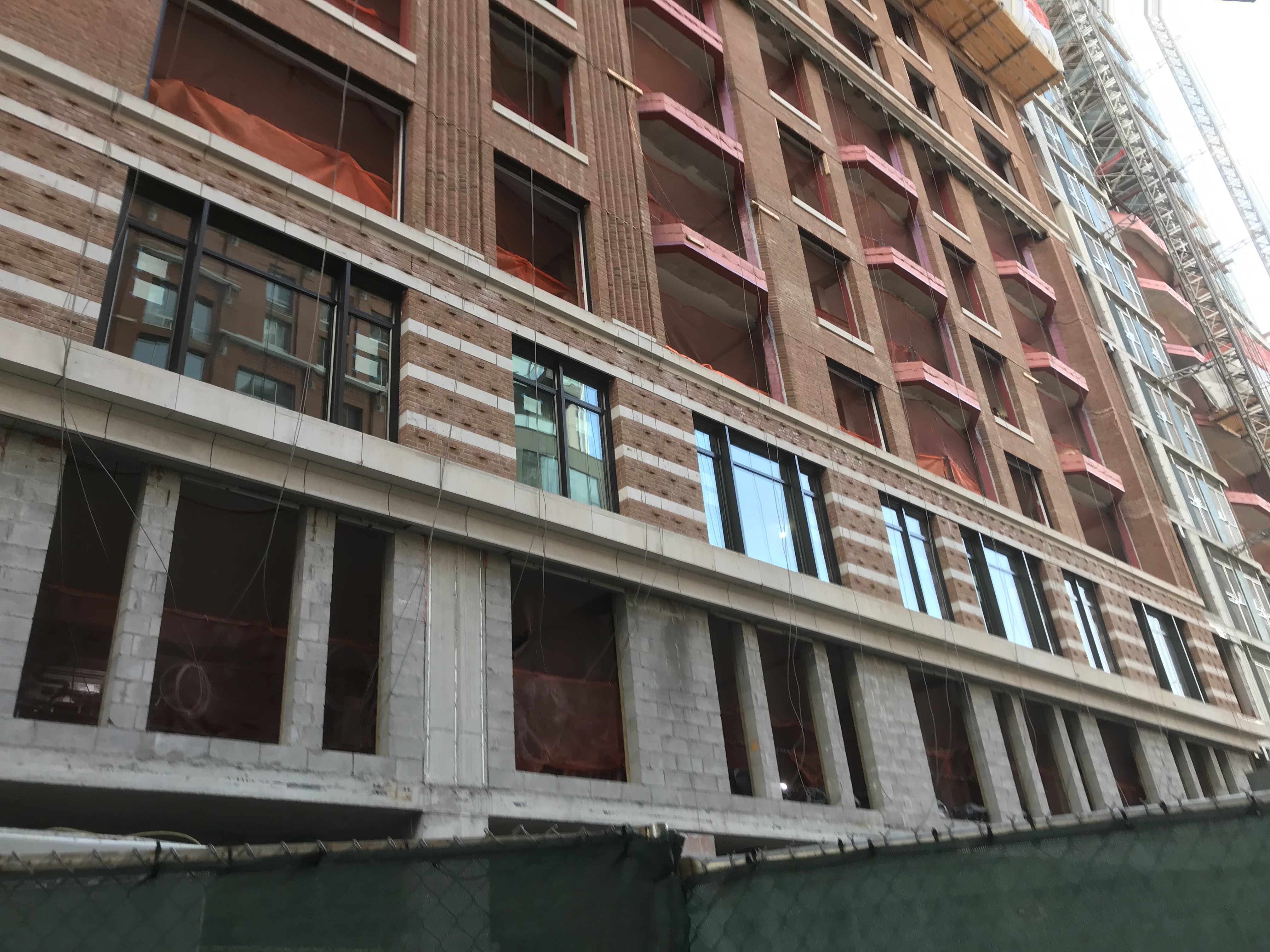

The first indicator are the continuous thin horizontal lines above the windows, and also on the solid wall section in the photo.

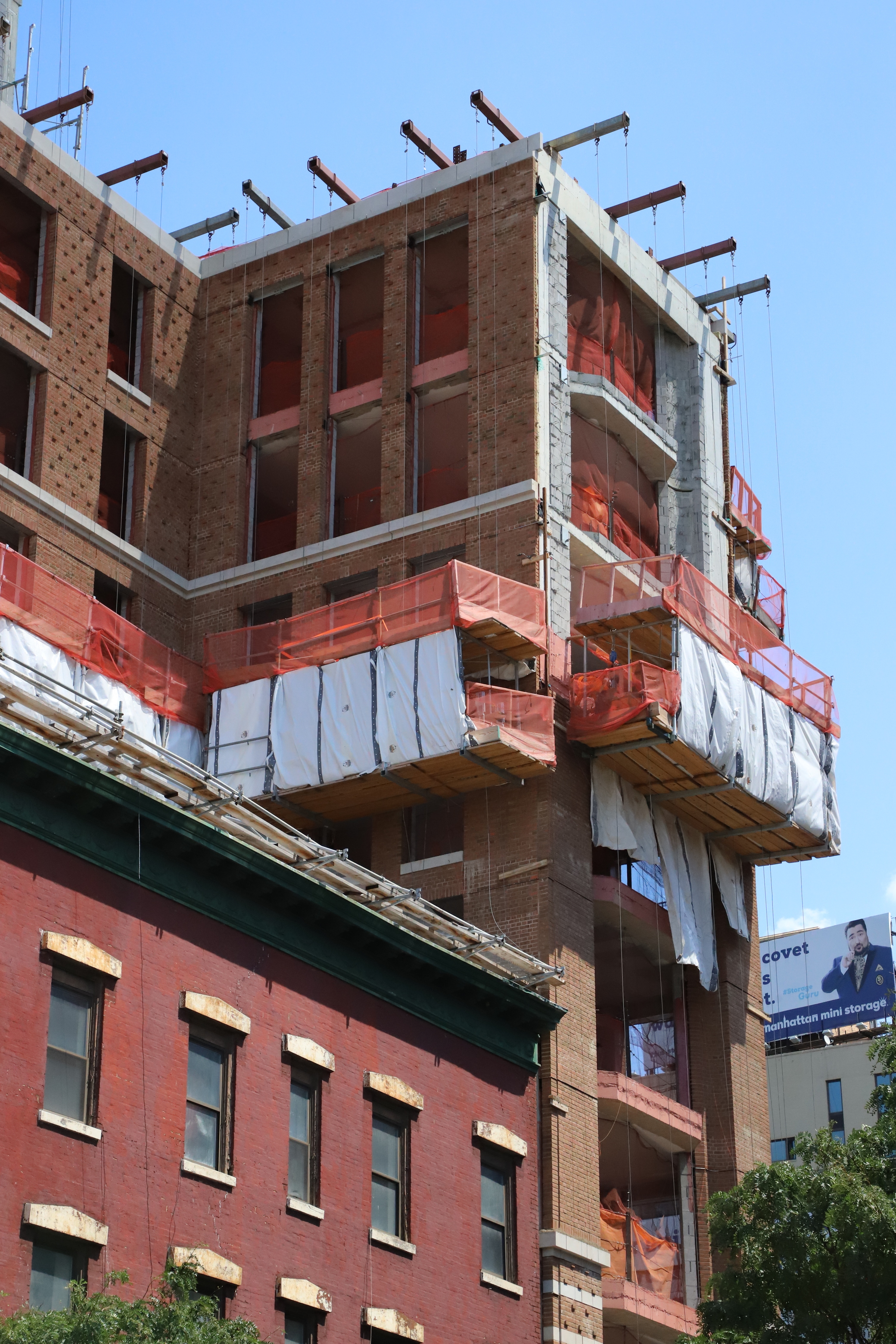

In addition to those thin horizontal lines, the most conclusive indicator of a ‘panel system’ facade is all of those metal bracket plates you see attached to the concrete formwork: those plates are where the ‘panels’ get attached.
There is no other possible reason for all those metal plates than for the purpose of attaching ’panels’ to the facade of the building: that panel system is ‘prefabricated brick panels’. Only the people on the job, can say for certain, but I am confident enough to say publicly on this forum that this facade is not likely to be done by traditional ‘bricklaying’ methods.

Very interesting. Those seams and cleats on the left are a dead giveaway of a panel facade. And another thing to note: how many new buildings claim a ‘hand laid’ brick facade, but the bricks were hand laid into a panel, not on site.
