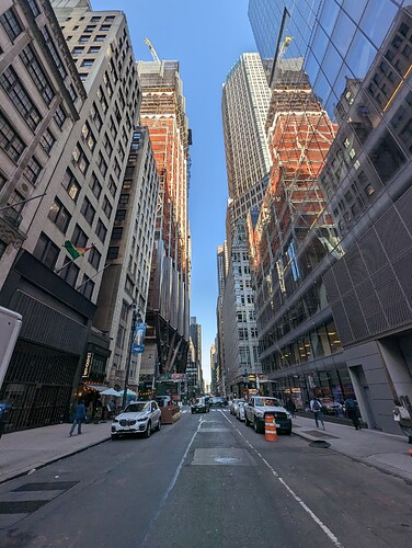

Its about ~775’, the setback should push it past 800’. ![]()
