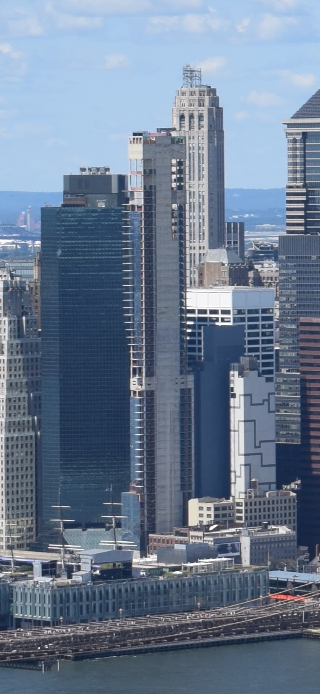

My conjecture is they used the wrong method - “unique foundation system” - for the foundation. The foundation footings are not drilled into the ‘bedrock’ beneath the ground/water; they used a different type of method.
There is a lot of detailed information on that subject posed on this thread. I surmise it is the ‘type’ of foundation that was done that is the root cause of the leaning: not the ground water.

I can’t imagine anything other than demo for this project. Given the soil conditions and the depth of the foundation it’s hard to conjure up a way to reinforce it. And straightening the thing out seems out of the question. I suspect the delay in a public announcement is because of the need for all the involved parties to settle up on who is going to pay what. While insurance companies will probably have to cover some of the cost, they may have viable legal cases against the architects, engineers and/or contractors. The negotiating table is probably fairly large.
All true. I was also thinking demo the only possible outcome because this structure is now both ‘unbuildable’ and ‘uninsurable’.
I say unbuildable because there was a previous claim that the tilt was not significant enough to warrant concern, and the foundation was “stable”. Even if the above were true, the facade contractor had to stop work mid-way up because the panels were not perfectly aligned with the superstructure; among other issues with attaching the ‘hangers’ for each facade panel. This tower is now ‘unbuildable’ , ‘un-insurable’ and unfeasible in every way possible.
So, yes - demolition seems the likely outcome here. I like “rumors” cause they so often turn out to be TRUE… ![]()

Good article; but the article states a “design defect”. I would think this was a “construction defect” that caused the building foundation to fail.
My limited understanding is that there is legal distinction between ‘design defects’ and ‘construction defects’.
‘Design defects’ often result from the design professional’s failure to produce an accurate set of construction documents. A design omission results from an incorrect design item or a scope of work that the design professional missed in the construction document.
A ‘Construction defect’ is the contractor’s failure to build a structure or component part of a structure per the construction documents. Such defects may include items such as an improperly installed weatherproofing system, soils that were not properly compacted, or improperly installed flashing.
Whatever the case, I don’t know for sure, given my limited understanding of the legal matters - regardless, this is one fascinating story in the annals of Design/Construction boondoggles. ![]()
I don’t think the label will make much difference on the legal side. The serious issue is which parties were responsible for what apparently was a flawed foundation. But I suspect the architects, typically required to regularly inspect the project and approve change orders, are on the hook for what reports say was an inadequate support structure. Others, such as a foundation contractor suggesting a change or a geologist saying the soil was good for what was installed, and who knows who else, may also be liable. This litigation will probably drag on forever. Meanwhile the city will have a decaying hulk on its hands. There must be other similarly disastrous projects but I don’t. Know what they were.
Strictly speaking, the contractor follows the architect/engineer drawings. Any deviation from the drawings is a construction defect.
