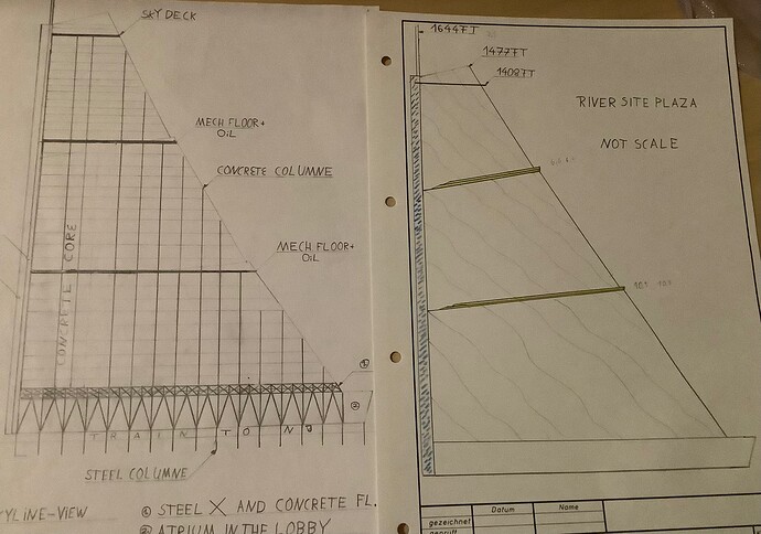

The use of the River Side would be combined (half hotel and half office). While it is rare that an office tower in NY has a concrete structure most have a steel skeleton.

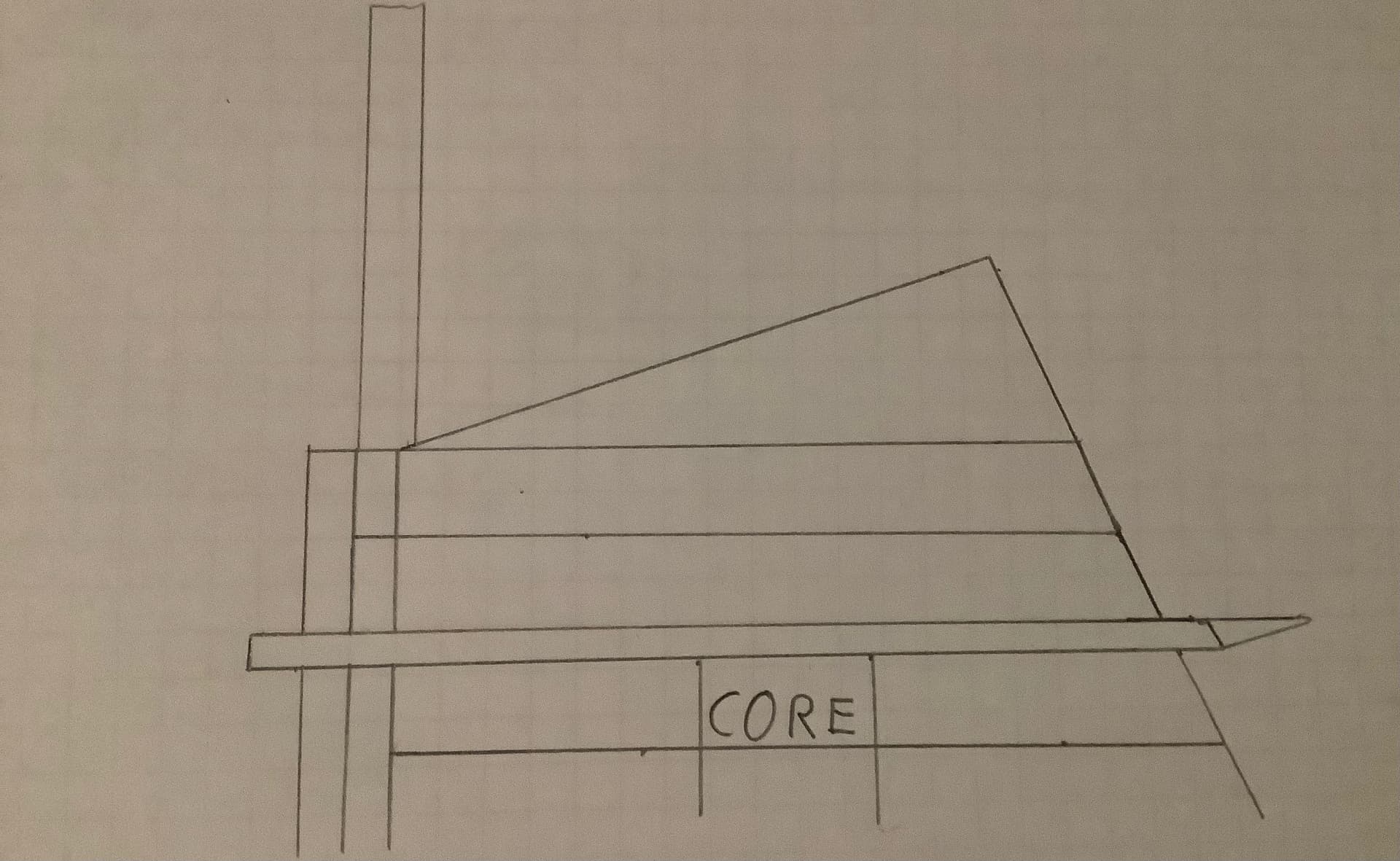

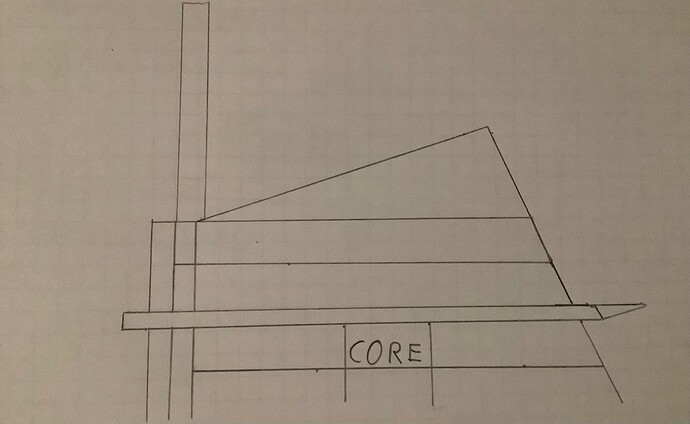

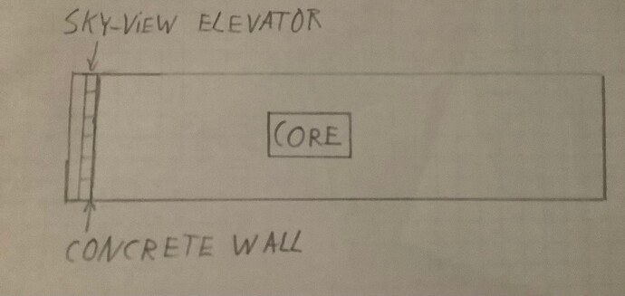

These are two very simple drawings a floor plan and a section through the sky deck.
Yes, I have to say that I have no idea if this works with the concrete wall. Since the wall goes from the 1st to the last floor through the whole building.
The platform of the Sky-Deck rests on the core.
Yes, using concrete is interesting as you’ve said, commercial buildings are built with steel, but general mixed-use buildings (as in your case) are also built with steel a majority of the time. I wouldn’t particularly see the usefulness of the singular concrete wall behind the deck elevators but it’s an interesting approach to load factoring.
What do you mean by load calculation?
The elevators that go to the sky deck are attached to the wall.
When you ride up in the elevator you see the skyline rising in the ride hence the name Sky-View elevator.
The “statics” as it is referred to outside of the US. Even though building usage is a major factor, material choice has a lot to do with load calculations and “statics” of the building structure. I’m not saying it’s unusual that you’ve designed a purely concrete building on top of a steel support structure, because buildings like that do exist, but it doesn’t make sense to use concrete in your case but for your core.

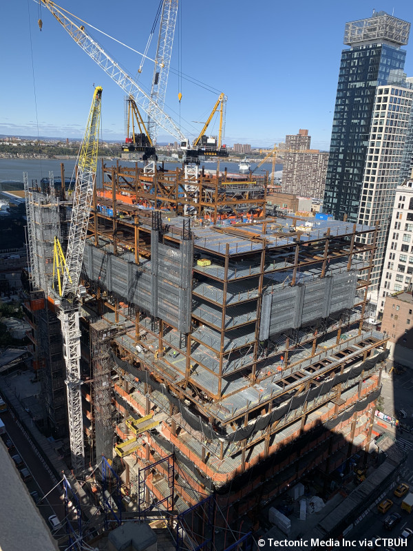

@Mackensen, @mcart is partially correct with his example of 270 Park Ave being built over an active railyard as concrete can’t be utilized in it’s case, but The Spiral isn’t built over any rails, it’s just using a steel reinforced concrete core (the steel visible in the image was later encased in concrete).
In general yes, steel buildings often utilize concrete cores (steel reinforced or not) to strengthen the building against lateral loads, outside of the range like old steel buildings like the ESB and Chrysler Building, the most recent examples of only steel buildings with steel cores would be 270 Park Ave and 30 Hudson Yards, both due to being built over active railyards.

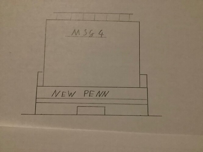

My renovation concept to Penn Station and MSG 4 (with Roof Garden) this is also just the first drawing.
I like that you’ve included, what I’m assuming is, 2 Penn in the drawing.

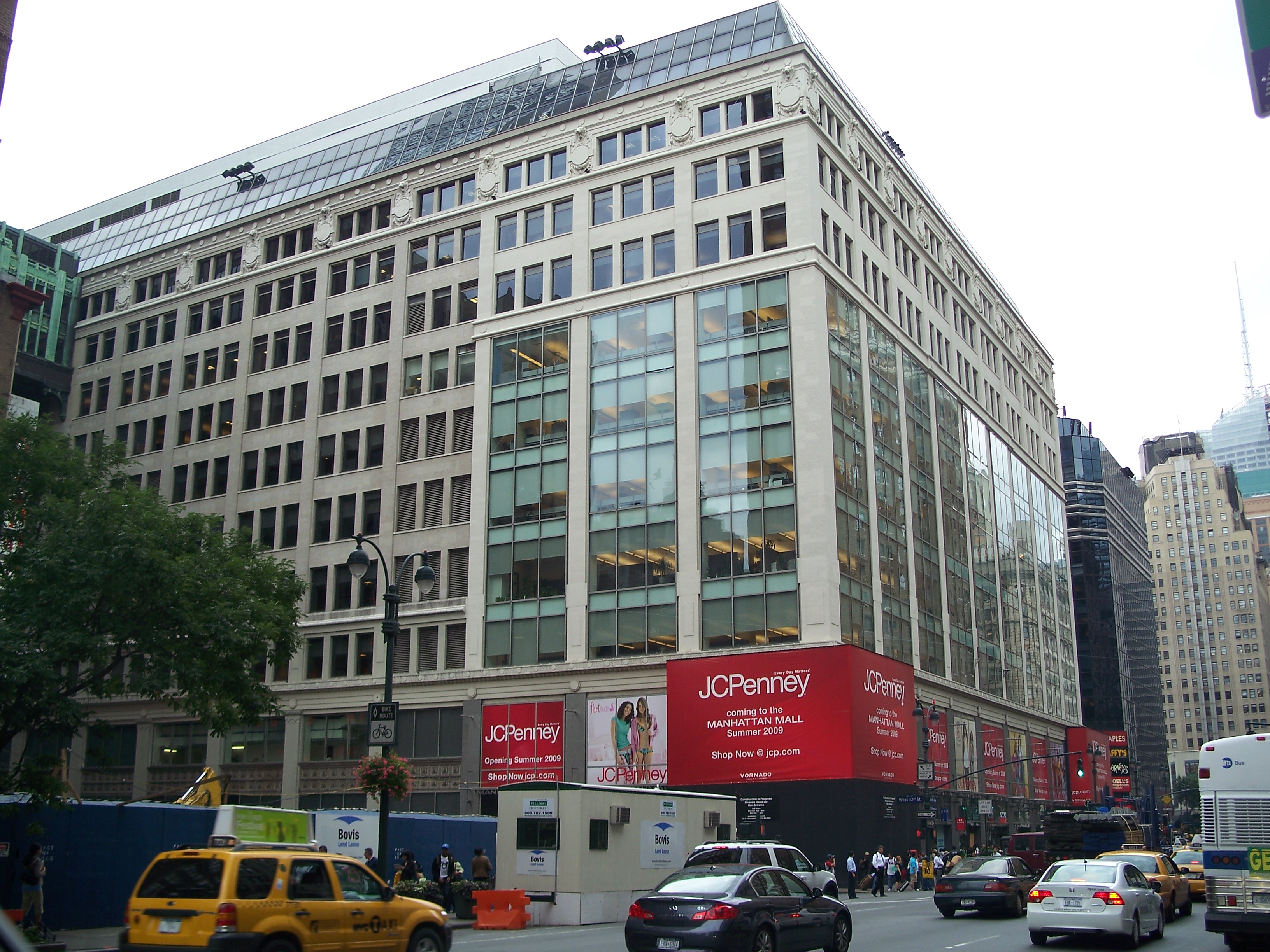

Could the Gimbel Store Building be demolished in the ESC redevelopment, or will a new tower only be built in the middle of the building so that the old facade is preserved?
Do the extension of lower Manhattan then rebuild the original Twin towers at the new tip. That would be my dream lol.
Only residential based FAR would be eliminated, it would just mean residential projects could be built/designed to be bigger with more residential units (not necessarily taller).
The fate of the Gimbel’s Building will be determined by which tower proposal Vornado chooses to go with on the site, whether commercial (which demolishes the building) or mix use with commercial and residential (which proposes to just build ontop of the building). But this is only how its proposed, either decision could result in demolition but the commercial only option does result in demolition.
