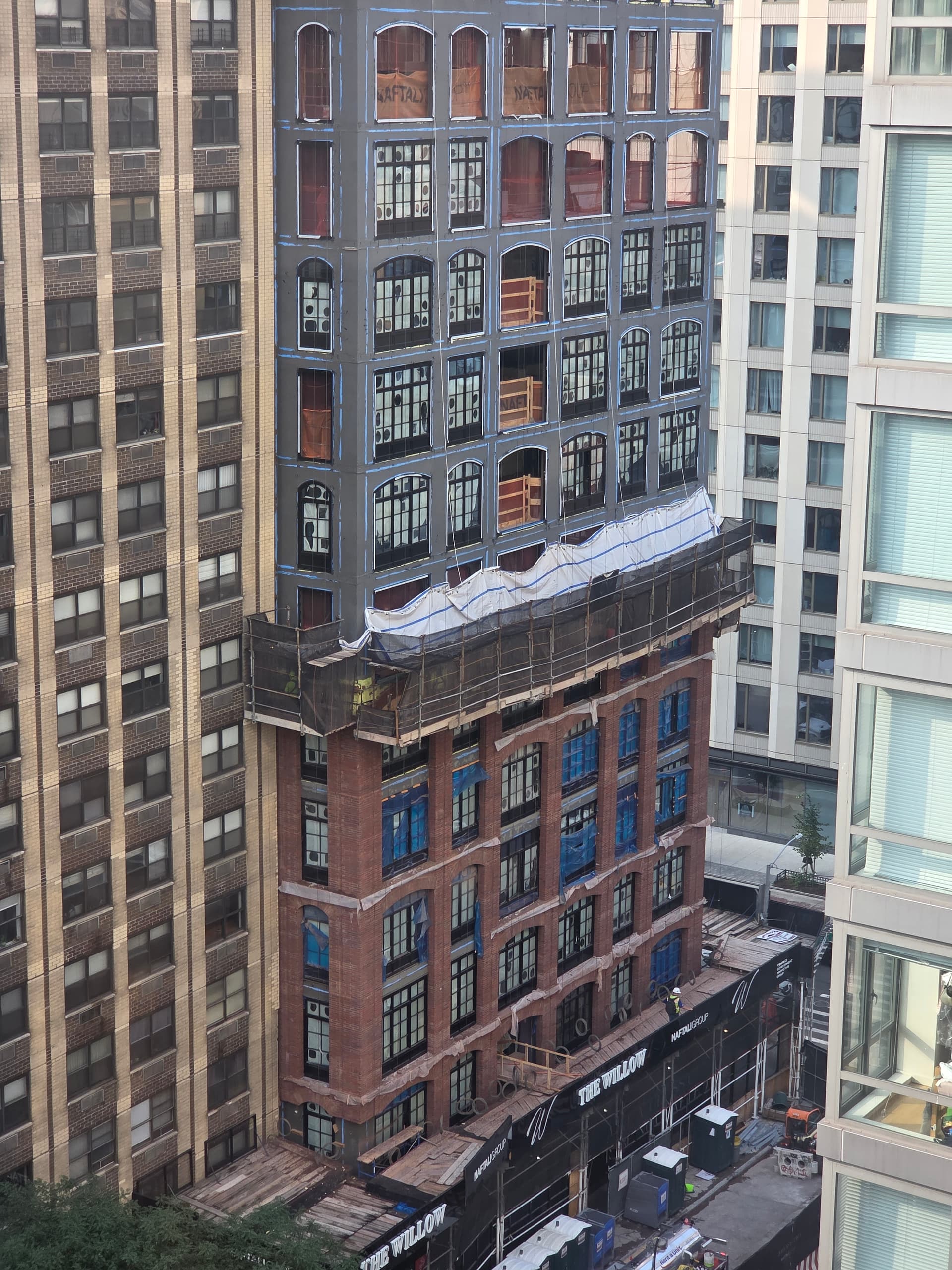

These bricks are being hand laid (this is always clear when the type of scaffolding visible on the building is present), they aren’t hung on prefabricated panels/other panels.
@stache So while they are still brick veneer in the sense that they are non load bearing, yes there is still potential for spalling.
Wow. I just took another look at the photo set posted above on Field Condition. Photo #10 shows the raw concrete terrace with a few loose bricks laying around - proof positive they are hand laid.
I am impressed - the quality of the work of the craft trades on this project is wonderful to behold.

That’s interesting. I walked by it the other day and I noticed the brick laying isn’t starting at the base. I just assumed they were panels.
Though it makes sense to think that bricks would be laid starting from the bottom, bricks can start being laid anywhere there is a support ledge.
