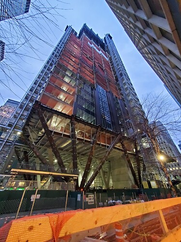

I was wrong - this is not a ‘core first’ construction method. I checked. The structural steel frame, and floor plates are built first - then the core rises up in stages.
This is not ‘typical’ as is the case with the concrete core first. I only know this is much preferred by the steel workers because they get to build the steel superstructure ‘unimpeded’ by other trades.

yes, thats more of a correct description
That’s still incorrect, there is no rise first or rise after with this tower, the core just rises with the structure because it is apart of the structure.
For the last time, there will not be a reinforced concrete core in this building…

What is the core made of - structural steel? I guess that is the only option.
The B1m video must be wrong; they clearly illustrate that the floor plates rise up ‘first’ several floors, then the core follows in sequence; the core then built-up to the level of the upper most floor plate.

Yes, you can see that with the elevator shafts on the lower floors. I was wondering where they were in the early days of construction.
Early days of construction by what terminology? The steel for the lower tier elevator shafts wasn’t added until a few month after the table top began construction. But they still aren’t encased in concrete. And vertical concrete that is visible on the ground level does not continue up past the tabletop mezzanine level and does not have any relation to the “theoretical” core of the building on the ground floor.
The lower tier’s “core” of elevator shafts is just built of secondary structure with steel plates enclosing them and will eventually be fireproofed and fire/encased in most likely 2 hr rated gypsum sheathing. The same will go for the actual core of the building where it starts on the upper levels of the lowest tier before the first setback but it is made of the primary steel structure. There is no building afterwards or before in this building as it relates to the core, but for structure relating to cladding, it is all built at the same time.
Took some photos (on my phone though) to show the construction of the elevator banks, the structures with lines all over them. The concrete boxes do not relate to the cores, they are fortifying the fire exits/stairs and various service elevators at ground level. Past that point, they are just cmu walls and the elevator shafts the continue plate steel encasements.

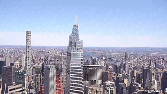

Caught the EarthCam as it was calibrating just now. While it calibrates it rotates and gives a better angle of construction.
